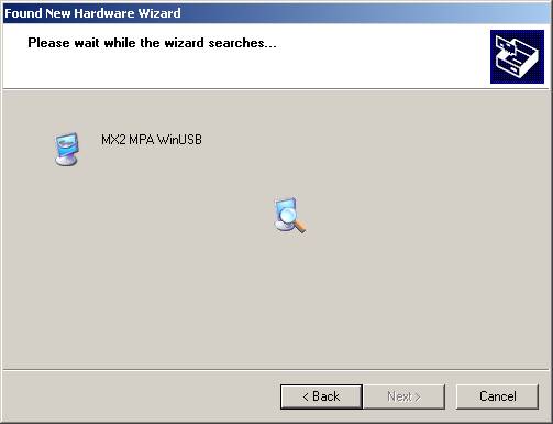

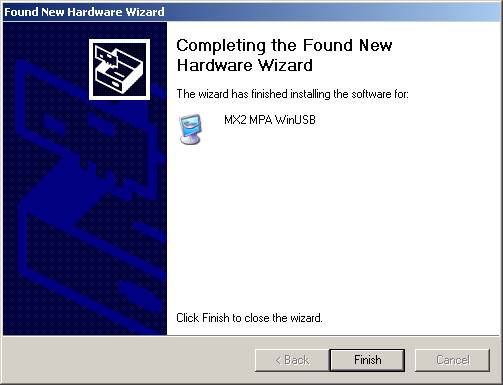

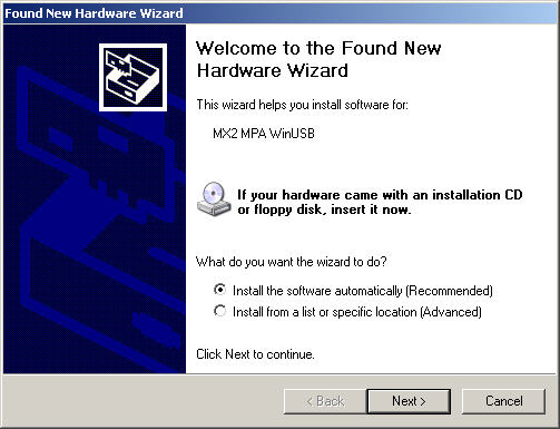

When the USB is connected to the computer it will launch the Found New Hardware Install Wizard.  Follow the on screen installation instructions:

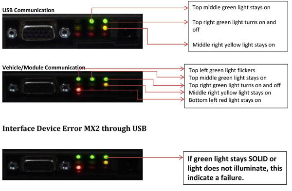

MX2 LEDs
Properly Connected MX2 through USB

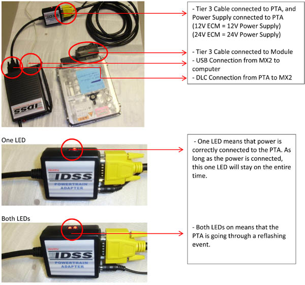

PTA (Powertrain Adapter) LEDs
Connection of MX2 through PTA to Tier 3 Module.
Note:  A Tier 3 cable is used in this example, but the
same type of connection would be used for a Tier 4
cable that is connected to a Tier 4 module.
