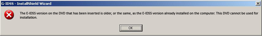

Note:  If the E-IDSS version on your PC is newer, or the same, than the E-IDSS version on the E-IDSS Periodic DVD Update, the E-IDSS Periodic DVD Update
will not be installed.

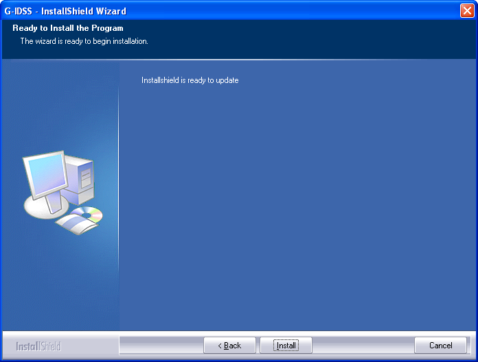

The following screen will be displayed when the correct software update preparations have been completed.
When this screen is displayed, select "Install."
When the DVD that has been inserted is older, or the same, as the E-IDSS version already installed on the computer, the following
screen will be displayed.

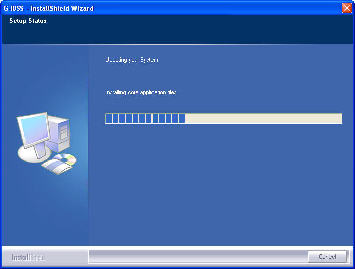

Installation is processing (updating) screen.

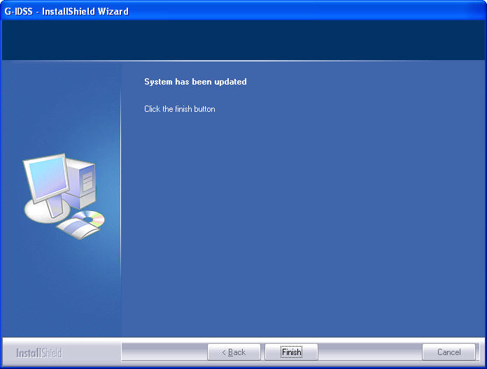

Installation complete screen.
When installation is complete, click the "Finish" button.

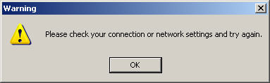

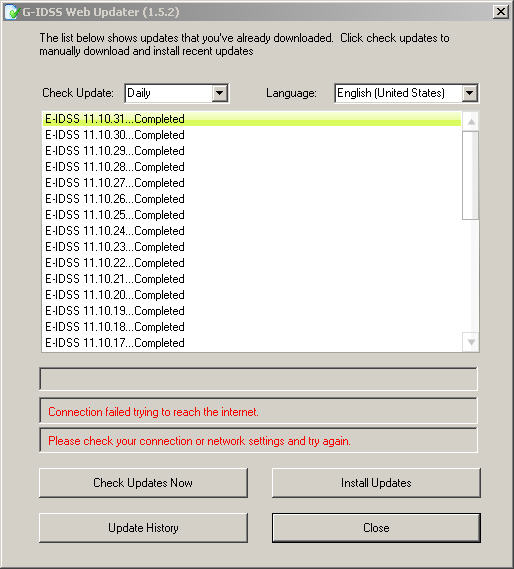

The Web Updater will automatically run.  When processing a Web Update at this time, follow the on-screen instructions.
After connecting to the internet, the Web Updater will perform the update.
When only performing an update using the DVD, it is not necessary to connect to the internet.
Please terminate the process.
