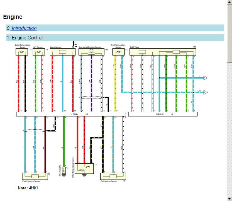

Electrical Schematics
IDSS contains electrical schematics/ETM for the engine selected.  Navigate through the Table of Contents (TOC) by clicking on titles to find information you would like to view.  When a title in the TOC is selected, the associated information will display on the right side.  Scroll down to view all text and graphics for the title selected.
The Schematics section lists all schematics for the engine.
Click on the image displayed to open it in an image viewer.  When the image viewer opens it has a toolbar at the top.
The toolbar allows the user to select desired actions or functions from within the viewer.

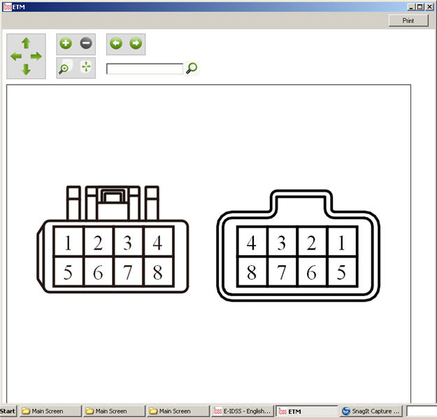

ETM Links
There are linked areas within the ETM image viewer that, when selected, will open a window with information pertaining to that area of the ETM.
This function is primarily available for component and  connector views.

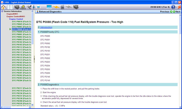

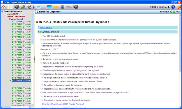

Enhanced Diagnostics

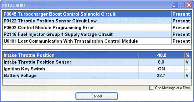

The Enhanced Diagnostics function allows you to view "live" values of parameters mentioned in the diagnostic charts of the service manual.  If Enhanced Diagnostics capability is available for the diagnostic chart you are viewing, an "Enhanced Diagnostics" icon will be present at the top left corner of the service information toolbar.  In Enhanced Diagnostics, during diagnostics, it is possible to display a data parameter which is related to the DTC.  For Enhanced Diagnostic DTCs, the “Enhanced Diagnostics” icon will be displayed in the upper left of the service tool bar.
When you click the "Enhanced Diagnostics" icon, a new window will open.  This window will display "live" values from the engine for all parameters discussed in the diagnostic chart.  This window will also display DTC status for the ECM diagnosed by that chart.
NOTE: You must be connected to the machine to view Enhanced Diagnostics live data.  If you are not connected to the machine when you click the "Enhanced Diagnostics" link, or if you lose your connection to the machine while viewing Enhanced Diagnostics, IDSS will inform you to correct your connection to the engine and/or IDSS interface device.
If you are not connected to the machine, you can still view service information without the Enhanced Diagnostics live data.
